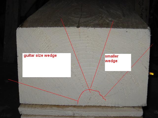

Here are some pictures I just took.
As you can see, there is a crack running in the middle of the beam. I am planning to split it in this crack, then start resawing from there.
To get the most tops, I plan to resaw some at 90 degree then to keep my resawing radial take some wedge (for mando or violin, etc) then some more continue with more guitasr tops.
What do you think.
My fellow should have left it thicker

BTW, I was told this is white spruce.

PostPosted: Mon Jul 23, 2007 3:44 pm
Posts: 503
Location: Portland, Oregon
Alain,
    Because of the length(and assuming you are looking for two billets). I might be tempted to clip the end to see how deep those little checks in the end are going(generally they are not super deep, but if you split the board and one runs a little deep you could lose both of your billets potential, and these are the end checks that I mentioned killing my billets potential yet looked pretty harmless). Don't clip much length when you are trying to see how deep they run, just a little at a time, until you are confident you have clean wood. Then evaluate your length knowing you have solid wood at each end.
For what it is worth, and this is only my thought from glancing at the picture. After confirming the length of solid wood, and if I was after guitar tops. I would cut to two billets, then split a wedge using the left side of that board(of course I would look close at both ends of the billets before splitting to make sure everything appeared to align and I had the best chance of getting a good wedge. It looks to me(and based on dimensions you mentioned) that that corner could yeild the best chance to get enough side on your wedge and get close to well quarter). I would not use the edges as they are cut now to cut tops as you are going to get odd grain orientation. I kinda ruff sketched up your picture(again you have to look the wood over, because I can't be sure this is best without looking at the wood more closely. just take my suggestion as a ruff idea as to what I would look to do.).
Peace,Rich
PostPosted: Mon Jul 23, 2007 4:19 pm
Hey Alain, Rich has some good advice, but I would offer another
suggestion as I thnk you will be using this wood for yourself rather than
marketing this wood where defects are not acceptable. Cut your 48 in
length in half, then start to split out a billet or two from each bolt and
then resaw them into tops. You may have some end checks in some of
the top sets but the reality is that at a 24 inch length you have 4 inches to
play with and since the end that you just cut to get the 24 inches was just
cut it should have no checks. You should though get at it my friend
before these cracks grow in size and propogate, you have to work around
the major crack but the rest I wouldn't worry about just yet.
Good luck and let us know how it turns out!

PostPosted: Tue Jul 24, 2007 11:00 am
Posts: 107
[QUOTE=Alain Lambert] Oops forgot the pictures...
2007-07-23_202429_IMG_0440.JPG">
2007-07-23_202446_IMG_0441.JPG">[/QUOTE]
"What do you think. "
Hi Alain....
You can cut this up for grins and the experience, but it looks like
firewood to me....
Wide, uneven graining that resides too close to the center of the tree are
the culprits....
Just my .02....

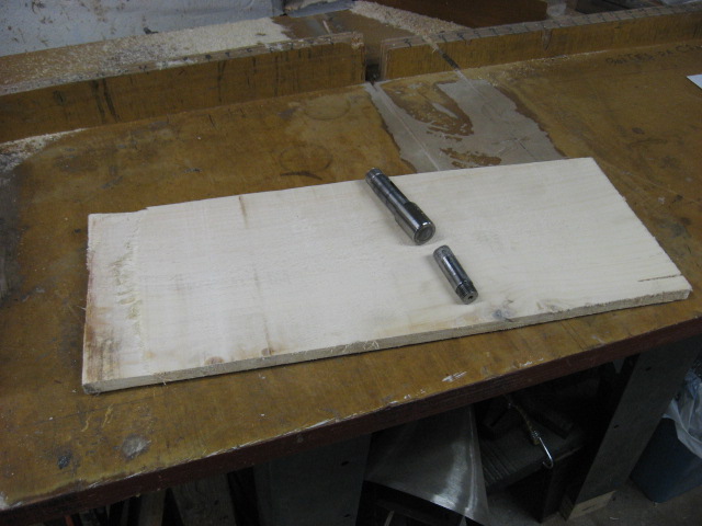

OK he is what I did:
I cut it in 2 no problem.
Split it 2 one of the half, smooth it with my No7 jointer plane and to the band saw!
Result: One nice wide grain (4 line per inch) board and a broken band saw shaft.
I put my 3/4" resaw blade on my Chinese 14" band saw crank the tension may be a bit higher than usual and voila!
I will put this in experience.
Note to self: Never do that again ! Buy from Shane.
Spruce you are right, I had seen the wide graining but was hoping to find some finer between once I cut.
PostPosted: Tue Jul 24, 2007 12:09 pm
Awe MANNNN!!!!! That sucks Alain, hopefully you can get parts. I too saw
the wide grain but if it is stiff it will work for guitars, you learn nothing until
you try, that is my thoughts anyway. Good luck fixing up the saw.
PostPosted: Tue Jul 24, 2007 12:26 pm
Posts: 318
Location: Trois-Rivieres
First name: Alain
Last Name: Lambert
City: Trois-Rivieres
State: Quebec
People says it all the time here that these small bandsaws are not tough enough for the wide blades.
Now I believe !
Shane, let me know when you have Lutz special again
PostPosted: Tue Jul 24, 2007 12:39 pm
Tuff luck Alain, we live and learn. Guess now you might want to try soaking that Chinese saw in a tub of water
PostPosted: Tue Jul 24, 2007 12:42 pm
Posts: 503
Oh man , Sorry to hear about the saw.
Hopefully you will keep an open mind and maybe give it a shot again some day. Next time you will be much more familiar with how to go about the process. You gave it a good go though, and cheers to you for the effort
PostPosted: Tue Jul 24, 2007 1:01 pm
Alain, don't run that big of a blade on that small of a saw it won't handle it.
Actually, the blade guys say that the blade won't handle it because they aren't made to bend that tight of a bend. (this comes from the guys as Sufolk)
Rather than try to get tops out of that board, what about brace wood. Looks like a lot of it to me.
PostPosted: Tue Jul 24, 2007 1:20 pm
Posts: 318
First name: Alain
Last Name: Lambert
State: Quebec
The grain is very wide. Not sure it would make good braces.
I have painted both end, just in case, and leave it to dry until I repair my saw. It may very well crack and split itself in brace wood, by that time.

Hey! this is a wide grain piece!
Is that any good?
I can get a replacement shaft for my saw from Busy-Bee. $15 + shipping. Not too bad.
